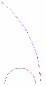

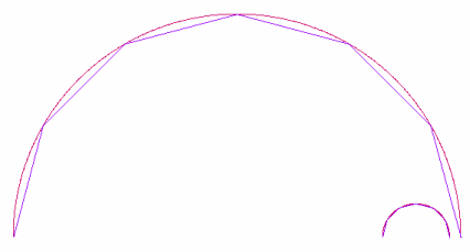

Consider two arcs with the same sweep angle of 180 degrees and primary radius of 10 and 1.5 units respectively.
a. Stroking the arcs using 30 degrees per edge will result in the following:
The resulting line from stroking the smaller arc is more accurate than the line from the bigger arc.

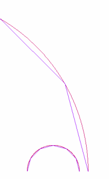

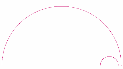

b. Stroking the arcs by setting the Stroking Tolerance to 0.1 units will result in the following:
Both resulting lines from the smaller and bigger arcs have the same accuracy, that is, the distance from the mathematical arc is never more than 0.1 units.
