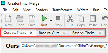

A git merge command (or its equivalent) between two conflicted files can launch the Compare tool. You can compare in three ways:
  • Your version ("ours") and the version with which you are in conflict ("theirs"). This view allows you to see differences and perform Copy to Left actions to resolve conflicts between your version and "theirs." Copy to Left effectively performs a merge that is directly reflected in your git tool.
  • The "base" version and your version ("ours"). "Base" is the version from which yours and "theirs" both originated prior to the latest revisions. This view is for your information only; neither file is editable.
  • The "base" version and "their" version. This view is for your information only; neither file is editable.
Each view is selectable as a tab at the top left of the Compare tool: (According to the configurations in Setting up the Integration (below), the tabs appear like this, but you can adjust the labels according to your own settings.)

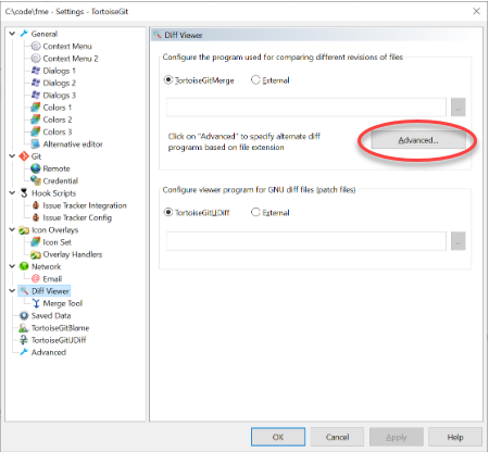

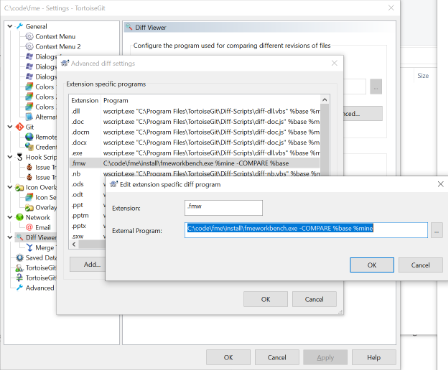

  1. Configure Diff Integration
    1. Go to TortoiseGit Settings
    2. In the left panel, select DiffViewer.
    3. In the Diff Viewer pane, click Advanced.
    4. In the Advanced diff settings dialog, click Add.
    5. In the Edit extension specific diff program dialog, specify the following:
      • Extension: .fmw
      • External Program: <fme install dir>/fmeworkbench.exe -COMPARE %base %mine
    6. Click OK to close out of each dialog.
    7. Now, when using TortoiseGit to compare revisions, FME Workbench will launch the Compare tool, comparing the two files.

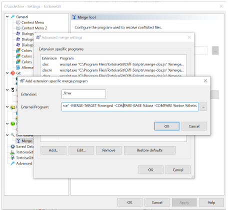

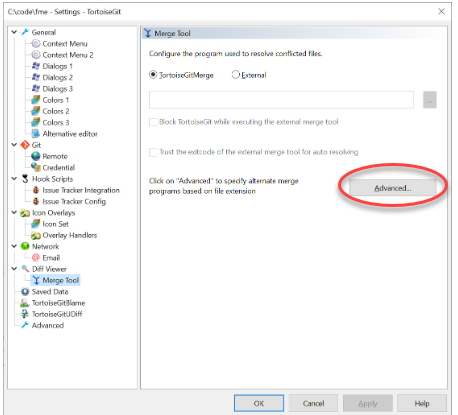

  2. Configure Merge Integration
    2. In the left pane, select Merge Tool.
    3. In the Merge Tool pane, click Advanced.
    4. In the Advanced merge settings dialog, click Add.
    5. In the Add extension specific merge program dialog, specify the following:
      • Extension: .fmw
      • External Program: <fme install dir>/fmeworkbench.exe -MERGE-TARGET %merged -COMPARE-BASE %base -COMPARE %mine %theirs
    7. Now, when using TortoiseGit to merge revisions, FME Workbench will launch the Compare tool.

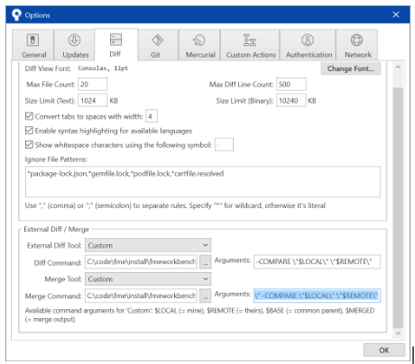

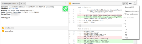

    1. Go to Tools > Options.
    2. Click the Diff tab
    3. Under External Diff / Merge, set:
      • External Diff Tool: Custom
      • Diff Command: Navigate to fmeworkench.exe
      • Arguments (corresponding to Diff Command): -COMPARE \"$LOCAL\" \"$REMOTE\"
    4. Click OK.
    5. Select a commit that has a change to a .fmw file, and click on the .fmw file.
    6. Click the diff settings icon, and select External Diff to launch the Compare tool in FME Workbench.
      • External Merge Tool: Custom
      • Arguments (corresponding to Merge Command): -MERGE-TARGET \"$MERGED\" -COMPARE-BASE \"$BASE\" -COMPARE \"$LOCAL\" \"$REMOTE\"
    4. Click OK.

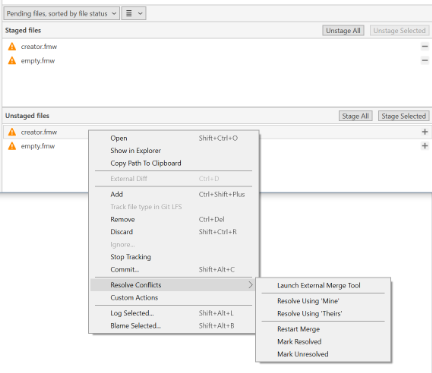

    5. Select a branch to merge that has a conflicting change in a .fmw file, and merge it.
    6. From the context menu on the conflicting file, select Resolve Conflicts > Launch External Merge Tool to launch the Compare tool in FME Workbench.
