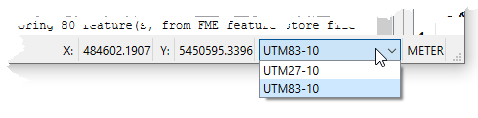

A view may reference multiple coordinate systems. For example, if your view comprises two datasets, one dataset may reference one coordinate system, and another dataset may reference a different coordinate system. Or, your view may reference a background map in a different coordinate system than your dataset(s).
If your view references more than one coordinate system, the Status Bar shows them in a drop-down list. The coordinate system that is currently selected is the one that is referenced when you view coordinate locations , and also when Measuring Distances. You can use this drop-down to change which coordinate system you want to reference.
