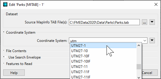

  1. In the destination dataset area of the Navigator pane, double-click the Coordinate System parameter.
  2. In the dialog that appears, you can either click the Browse button to display the Coordinate System Gallery or enter a prefix or character string that will display a list of matching selections. For example, if you type the string "UTM" you will see these matches:
FME will reproject the data to the coordinate system that you enter in this field, and the Navigator pane will display something similar to this:
