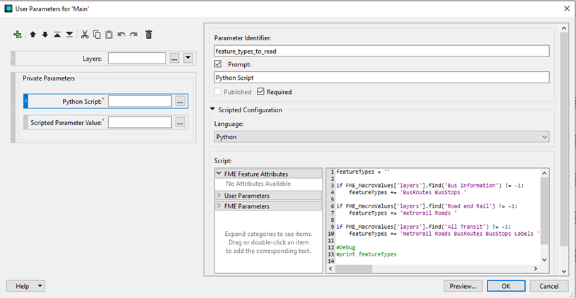

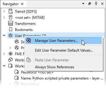

Open the Workbench User Parameters dialog.
The parameter is defined using the following options:
Write the Python Script
Click the browse button beside the Value field to display the source code editor. The code in the editor is described here:
Code Description
Initially set featureTypes variable to empty.
If you choose Bus Information for global parameter Layers, set the feature types to Bus Routes and BusStops.
If you choose Road and Rail for global parameter Layers, set the feature types to metrorail and Roads.
If you choose All Transit for global parameter Layers , set the feature types to metrorail, Roads, BusRoutes, BusStops and Labels.
Note  Your code must contain a return statement on the last line of code. If there is no return statement (and assuming there is more than one line of code) FME will add return to the beginning of the line. Example for single lines of code:
When finding the last line of code, multiline statements or comments are not supported.
Return the featureTypes variable.
The feature_types_to_read global parameter will be set to the value of this return.
The feature_types_to_read global parameter is linked to the reader Feature Types To Read parameter; therefore, the feature types that are read will be the feature types specified in this return value.

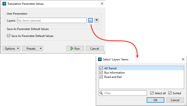

To run the workspace, select Run > Prompt for Parameters or press Ctrl+r.
Prompt and Run will display a Translation Parameters dialog. The translation will pause until you choose which layers to group.

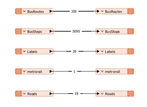

If you Select All, the features are set to all feature types:

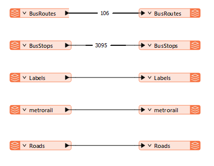

If you select Bus Information only, for example, the feature types are set to Bus Routes and Bus Stops only:
