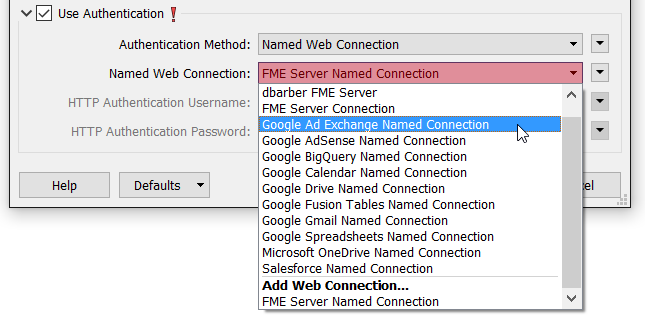

You can use an existing web connection, or define a new one, in Transformer Parameters, Add Reader, or Add Writer dialogs.

To create a new connection in a transformer, such as FME FlowJobSubmitter, and use it right away, select Add Web Connection.

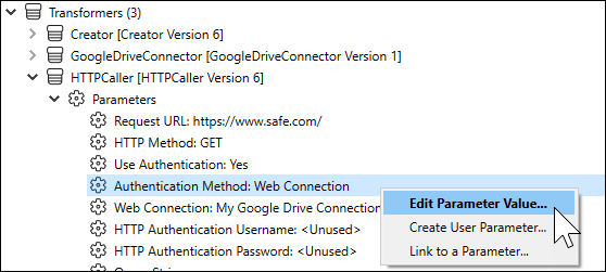

Reusing a Web Connection
After you create a connection, it is available for you to reuse along with any others you have created:
