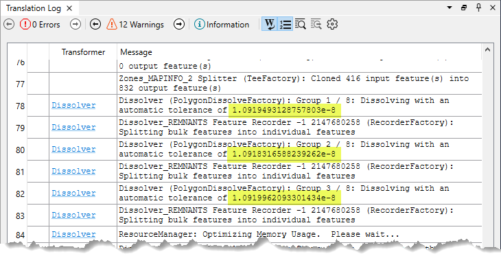

In this log, a Dissolver is processing multiple groups of features in a UTM coordinate system (ground units in meters), and calculating the optimal tolerance value for each group.
Note the values are extremely small, and each one very slightly different.
