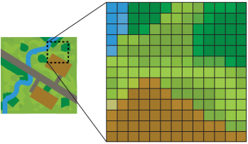

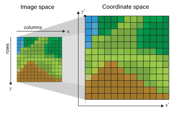

A raster is a rectangular matrix of evenly-spaced cells (sometimes called pixels), arranged in columns and rows.
A raster – and therefore its cells – has one or more bands (sometimes called channels or layers). A band’s interpretation determines what range and type of values it can hold.
Each cell has one numeric value per band.

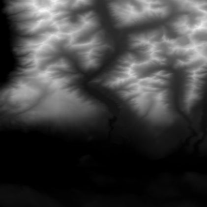

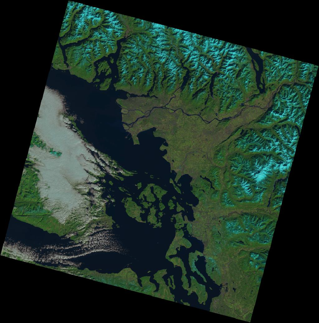

Rasters may represent image or numeric data. Images are commonly derived from satellite data or photography, while numeric data often represents elevations, temperatures, and other quantitative information.
The number of bands will vary – one for a digital elevation model (DEM) or simple numeric raster, three or four for most color image rasters (red, green, blue, and sometimes alpha), and even more for those produced with multiple sensors or representing measurements repeated over time.
Orthoimage
Digital Elevation Model
Numeric
Satellite: Multispectral

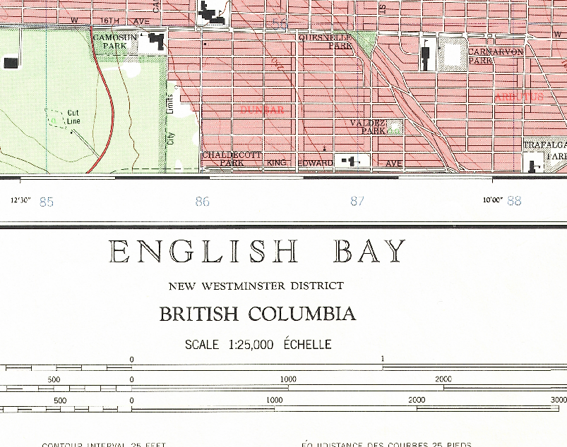

Scanned map
Some rasters are georeferenced, and know where they are positioned on the earth. Some, such as scanned maps, can be manually georeferenced. Some may be tied to a point on the earth (as is a photo with embedded GPS information) but the contents of the image are not georeferenced. Some may be associated with a geographic feature and stored as an attribute, common with scanned documents and images.

Ground Control Points (GCPs) are sometimes used to georeference rasters. If they exist on a raster, they will appear as a raster property.
Each GCP is a pair of locations, matching a cell (column, row) in the raster to a point in a coordinate system (x,y,z). A minimum of three GCPs are needed for georeferencing.
Raster Property
Description
Sample Values (Scanned Topographic Map)
GCP Coordinate System
The coordinate system of the referenced points (not necessarily the same coordinate system as the raster).
UTM27-10
A series of numbered GCPs, starting with zero (0), each consisting of a cell position (column, row) matched to a real-world position (x,y,z) in the designated GCP Coordinate System.
0: 6863, 1442, 483000, 5456000, 0 1: 1143, 1415, 483000, 5468000, 0 2: 1120, 4754, 490000, 5468000, 0
GCPs can either be applied to the raster, resulting in the image being georeferenced and tagged with the GCP Coordinate System, or the GCPs can be extracted and stored on the resulting data file for those formats supporting unreferenced data and GCP storage.

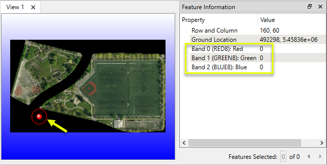

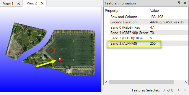

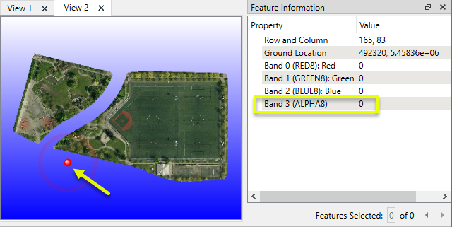

Alpha bands are often used with RGB rasters, forming RGBA. The alpha value indicates transparency, where zero (0) is fully transparent and the maximum value (255 if 8-bit) is fully opaque. This affects the display of the other bands, and is often used to create transparency where no data exists, as in irregularly shaped or rotated rasters which might otherwise have areas displayed as black pixels.
In this example, an irregularly-shaped raster is produced by clipping to a park boundary. Cells that fall outside the park boundary but inside the raster's rectangular extents are black.
By adding an Alpha band with the value zero (0) in locations that have no data, they are rendered as transparent.
Note that pixels in the Alpha band in locations where there is data – that is, color – have a value of 255, which is fully opaque.
Nodata is a designated value, per band, that is specified to mean no data – unknown or invalid, as opposed to null or zero.
Nodata is frequently displayed as transparent, but alpha and Nodata are not the same. In general, Nodata is useful for gridded numeric datasets, while alpha is useful for color rasters.

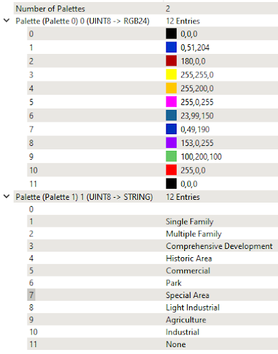

A palette is a lookup table (LUT), correlating a cell’s value with something else. That something else might be an RGB color, a word, or other value.
A palette is associated with a specific band. A band may have zero, one, or multiple palettes. Palettes can serve a number of purposes:
  • Reduce file size by paletting a color image, reducing three bands (R,G,B) to a single numeric band
  • Reducing file size or complexity of a raster by limiting the number of available values
  • Providing one or more thematic interpretations of a gridded dataset by applying colors or strings – often both, as in the color blue and the string Water.
  • Providing descriptive names for values
Rasters with palettes are sometimes referred to as classified rasters.
The palette consists of a series of pairs of palette keys and palette values. The palette key is matched to the band’s cell values, and must have the same interpretation type as the band. Bands must be a UInt8, UInt16, or UInt32 interpretation type to have palettes. Palette keys of UInt64 are not supported.
Palette values can be RGB24, RGBA32, RGB48, RGBA64, Gray8, Gray16, or String, as in this example:

The Name property optionally stores an additional name for the palette.
Key Interpretation
The interpretation type of both the related raster band and the key correlation values.
Value Interpretation
The interpretation type of the referenced value, such as an RGB color or descriptive string.
Palettes and Nodata
Palettes do not directly store Nodata values.
However, since the palette keys are intended to match the band values, a single palette key can be interpreted as Nodata if it matches the band’s Nodata value. This Nodata key also looks up to a palette value, which is then considered the Nodata value.
Removing and Resolving Palettes
Palettes can either be simply removed from a band, leaving the original cell values intact, or they can be resolved – that is, have the palette values overwrite the cell values.
If the palette values are RGB(A) colors, multiple bands are created to hold each component value.
The resulting bands will have their interpretation type adjusted to match the resolved palette values if necessary. The palette is removed.
String palettes cannot be resolved.
