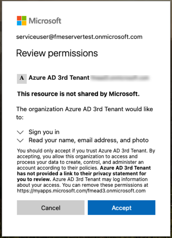

  5. Mouse-over for example:

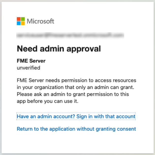

  2. A “Need admin approval” dialog opens.
  3. Mouse-over for example:

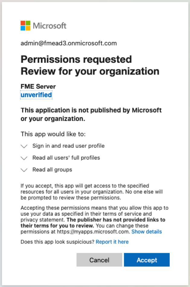

  6. Mouse-over for example:
