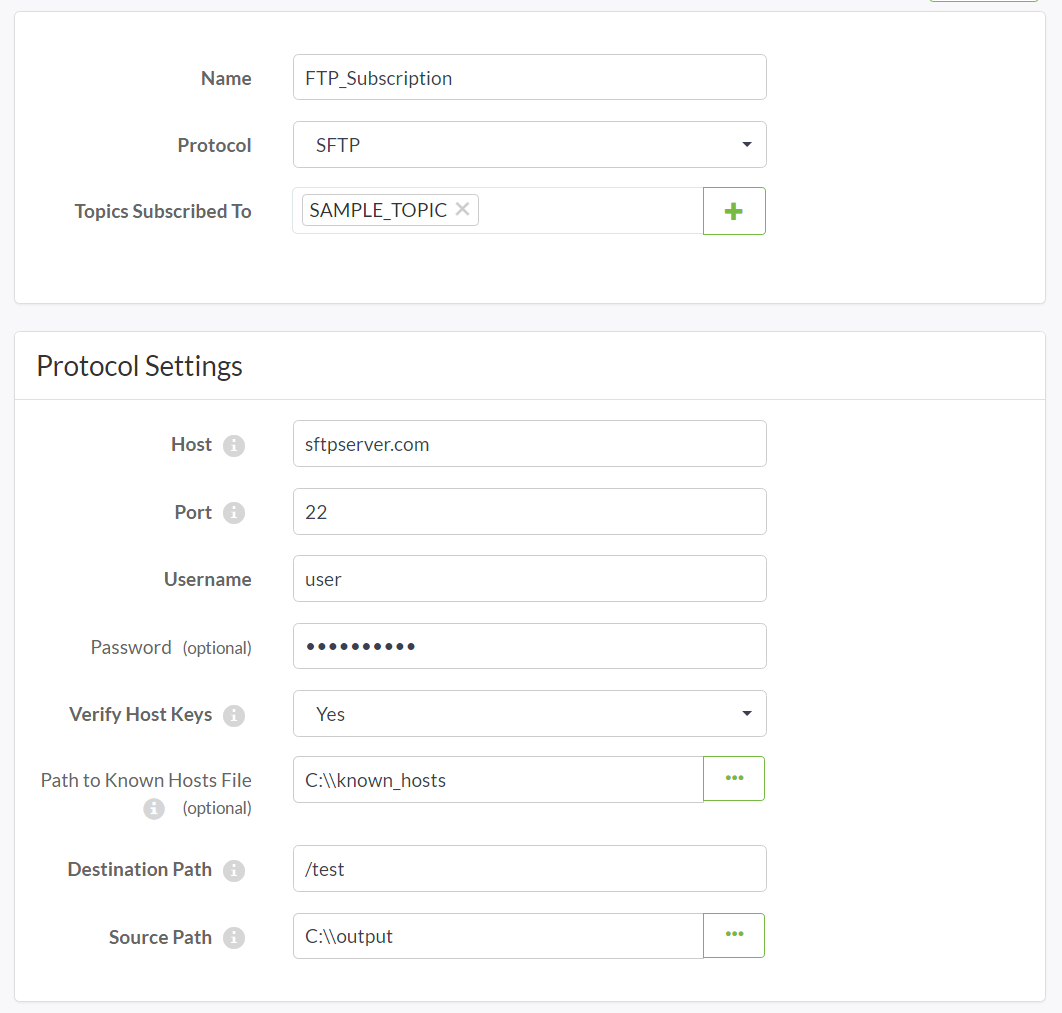

In the FME Flow Web User Interface, select Notifications > Subscriptions, and click Create.
Move pointer over example to view:
  • Name: Provide a name for the subscription.
  • Protocol: Select SFTP.
  • Topics Subscribed To – Specify the Topics you want to subscribe to using the drop-down selector. To create a topic and use it right away, click +.
  • Host – The SFTP host name.
  • Port – The SFTP port number. The default value is 22.
  • Username – The SFTP user name for authentication.
  • Password – The SFTP user password for authentication.
  • Verify Host Keys– Choose whether or not to verify the host key for the server being connected to.
  • Path to Known Hosts File – If Verify Host Keys is Yes, specify the path to the known_hosts file that contains the public keys for any servers you wish to connect to. If the known_hosts file is saved to a Resources directory, click the ellipsis (...) and select the file. Otherwise, enter the file path directly. File paths must use forward slashes (/) or escaped backslashes (\\).

  • Destination Path – The destination path to upload the file.
  • Source Path – The source file to upload. If the source file is saved to a Resources directory, click the ellipsis (...) and select the file. Otherwise, enter the file path directly. File paths must use forward slashes (/) or escaped backslashes (\\).
