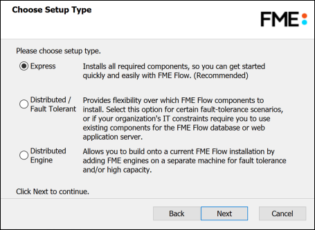

Choose Setup Type
Select the Express option.

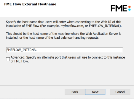

FME Flow External Hostname
If this FME Flow installation will be available to users outside an internal network (for example, on an external website), specify the external hostname that users will enter when connecting to FME Flow. For example, if you are hosting FME Flow on myfmeflow.com/myfmeflow, enter myfmeflow.com.
Otherwise, enter the internal server hostname, IP Address, or DNS.
If a load balancer or reverse proxy is deployed through which to access FME Flow, check Advanced and provide the External Web Traffic Port. Specify this port only if it differs from the port on which the FME Flow Web Application Server listens, as specified in the next dialog.

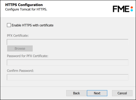

HTTPS Configuration
To enable the Apache Tomcat web application server for HTTPS, check Enable HTTPS with certificate and provide the path to your PFX certificate and the certificate password.
Note  If you do not configure for HTTPS during installation, you can configure it later. For more information, see Configuring for HTTPS.
