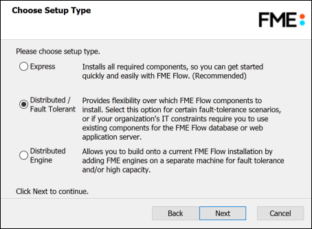

Choose Setup Type
Select the Distributed/Fault Tolerant install option.

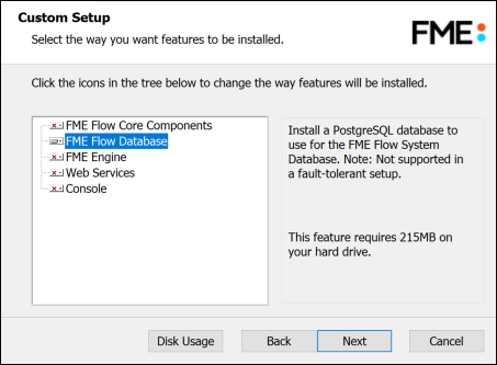

Custom Setup
Specify FME Flow Database. Unselect all other components.
Note  The FME Flow installer does not distinguish between the settings Will be installed on local hard drive and Entire feature will be installed on local hard drive. In either case, the entire feature is installed on the local drive.

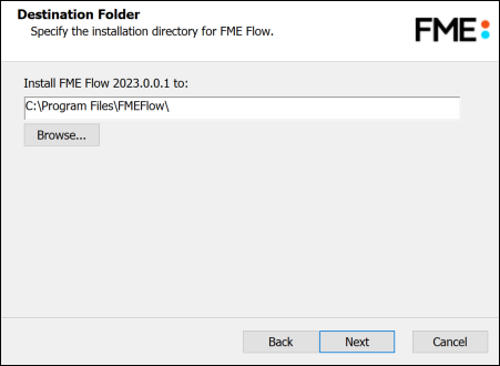

Destination Folder
Specify the installation directory for the FME Flow Database.

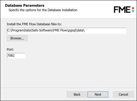

Database Parameters
  • Install the FME Flow Database files to: Specify a directory to install the database files.
  • Port: Specify the port that the database will listen on. Port 7082 is the default.
