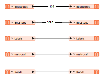

If you Select All, the features are set to all feature types:
If you select Bus Information only, for example, the feature types are set to Bus Routes and Bus Stops only:
