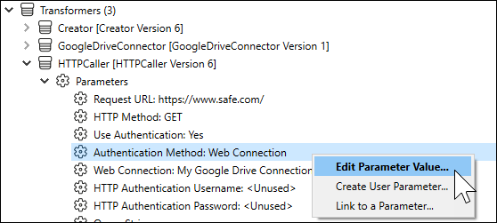

Working with Web Connections in a Workspace
You can use an existing web connection, or define a new one, in Transformer Parameters, Add Reader, or Add Writer dialogs.

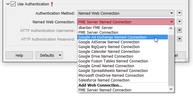

To connect to FME Flow, you can use a web connection that specifies the FME Flow web service. You can use an existing connection, or define a new one, in the publish or download wizard. For more information, see Connecting to FME Flow.
To create a new connection in a transformer, such as FME FlowJobSubmitter, and use it right away, select Add Web Connection.
In the FME Flow Connection dialog, specify:
- Web Service: FME Flow
- Connection Name: Specify a name for the connection.
- Server URL: The URL of the FME Flow. For more information, see Accessing the Web User Interface in the FME Flow documentation.
