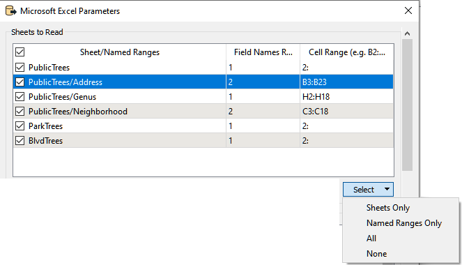

Sheets to Read
This section shows all of the worksheets and named ranges in the Excel file. A named range is of the form sheetName/NamedRangeName.
Example
In this example, the selected area is a named range: the name of the named range is Address, and it is on the sheet PublicTrees.
The column Field Names Row allows you to select which row contains the header names, and the column Cell Range allows you to restrict the information to read. If a cell in the Field Names Row is blank (if, for example, it is a merged cell), it will automatically be given the merged cell value.
The Select menu allows you to choose which worksheets/named ranges to read. By default, FME will select All.
If the column Field Names Row value is set to zero (0), then the column names will be set to the Excel column letters A, B, C, etc. This can be useful if there are no field names, or if they are not consistent. The Excel Reader only supports a single row of field names, and merged cells in the field name row will result in the value being duplicated for all columns it covers. To resolve attribute name duplication, additional numerals will be appended.

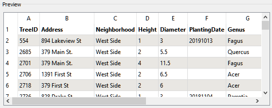

Preview
This section shows a preview of the data (up to 100 rows) of the selected feature type (either feature or named range). As shown in the example here, if you select a header row from the Sheets to Read area, that row will be shown in boldface text.

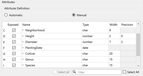

Attributes
This section displays the attributes that were created for the feature type (schema scanned).
- Exposed: Selected attributes will be added to the reader feature type. Unchecked attributes will not be added.
- Name: The attribute name that will be placed on resulting features.
- Type: The attribute type is listed in this column. You can change the attribute type by clicking on the field and selecting from the drop-down list. This only affects the resulting features if the selected attribute type is a coordinate type or a date type.
- Width: This value is ignored for attributes produced from this reader.
- Precision: This value is ignored for attributes produced from this reader.

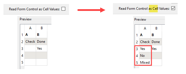

Read Form Control as Cell Values
The Excel Reader supports reading certain form controls as cell values. When enabled, the reader will check for form controls whose top left anchor is in an attribute cell and if present, will use its value to populate the attribute, overriding any other value that may reside in the cell. Only one form control per cell will be read – this will usually be the first control that was added to the sheet. Multiple form controls per cell are not supported.
Formatting, formulas, and hyperlinks may still be read from a cell with a form control if the appropriate option is selected.
Currently, only checkbox-type controls are supported. The possible values are:
- True (boolean) when the box is checked.
- False (boolean) when the box is empty.
- Mixed (string) when the box is filled with a pattern. This can happen when the form control is bound to a cell with the value #N/A or the formula =NA().
Example
In the input Excel file, cell checkboxes are shown checked, unchecked, and mixed:
After the file is read, the Reader Parameters Preview area shows the cells before and after Read Form Control as Cell Values is checked:
This form control is correctly positioned in row 6 and can be read as an attribute value:
