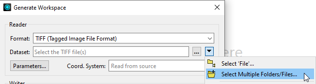

There are several ways to select multiple formats, but the File Browser and the Advanced Browser are the most common.
File Browser
The file browser is commonly used to select single datasets, but you can also use it to select multiple datasets when they are all stored in the same location.
Advanced Browser
This option is particularly useful when the source datasets are in different folders. All datasets to be selected must be the same format, and that format must be defined before the advanced browser can be used. The button will not activate until a format is set.
Access the advanced file browser tool from dialog by clicking the Advanced Browser button. It is also available on the Add Reader dialog. For additional information, see Adding Readers to the Workspace in FME Workbench help.

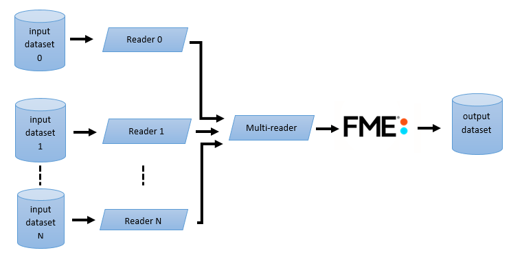

During an FME run, the Multi-Reader cycles through each individual reader and sends features on to the rest of FME as they are read. When the first reader reaches the end of its data, the second reader is activated. This continues until the Multi-Reader runs out of readers:
Multi-Reader Process
