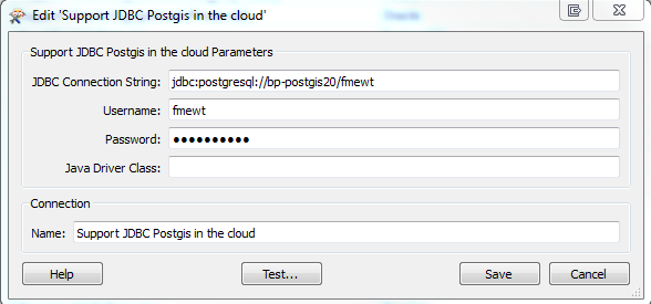

In FME Workbench, you can set up a Database Connection entry that uses the required connection string. Select Utilities > FME Options > Database Connections.
Once this connection has been successfully tested, it can be saved and used in any readers, writers, or transformers that want to connect using that particular connection string. For example:
The Java Driver Class is provided to support drivers that do not register themselves (pre-4.0 drivers or incompletely packaged version 4 drivers) and to ensure that the correct driver class is loaded to handle the connection string.
