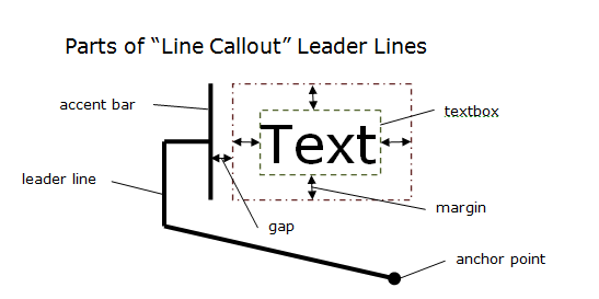

FME supports “Simple Line Callout” and “Line Callout” annotation leader lines represented as format attributes. Common between both are tolerance, line width, line color, and the anchor point. Simple Line Callouts can optionally have a geometry associated with them stored in geodb_leader_line. Line Callouts in Geodatabase have no geometry associated with them and are rendered directly in ArcGIS based on their attributes. To assist in emulating the rendering, FME provides a textbox envelope that can be used along with the style, gap, margin and anchor point attributes to determine where to place the leader line and accent bar.
Leader lines attributes will only be on annotations with an actual leader line. If the annotation is split, then the leader line attributes are only placed on the first part with the textbox being the envelope of the whole annotation.
Leader line attributes will override leader line symbols if a symbol id or annotation class id is provided. If just providing an anchor point, only the anchor point will be overridden; otherwise, the whole leader line symbol will be overridden.

geodb_text_lc_accent_bar_color |
The RGB color of the accent bar of “Line Callout” type leader lines. See geodb_color for a description of how color is represented in FME. |
geodb_text_lc_accent_bar_width |
The width in ground units of the accent bar of “Line Callout” type leader lines. |
geodb_text_lc_bg_fill_color |
The RGB color of the border fill on a “Line Callout” type leader line. Note This attribute is read only for geodb_annotation.
geodb_text_lc_bg_outline_color |
The RGB color of the border outline on a “Line Callout” type leader line. Note This attribute is read only for geodb_annotation.
geodb_text_lc_bg_outline_width |
The width of the border outline on a “Line Callout” type leader line. Note This attribute is read only for geodb_annotation.
geodb_text_lc_gap |
The gap is the space in ground units between the margin and the accent bar for “Line Callout” type leader lines. |
geodb_text_lc_margin_bottom |
The bottom margin in ground units of “Line Callout” type leader lines. |
geodb_text_lc_margin_left |
The left margin in ground units of “Line Callout” type leader lines. |
geodb_text_lc_margin_right |
The right margin in ground units of “Line Callout” type leader lines. |
geodb_text_lc_margin_top |
The top margin in ground units of “Line Callout” type leader lines. |
geodb_text_lc_style |
The style of “Line Callout” type leader lines. Options: base, midpoint, threepoint, fourpoint, underline, custom, circularCW, circularCCW |
geodb_text_lc_textbox_x1 geodb_text_lc_textbox_y1 geodb_text_lc_textbox_x2 geodb_text_lc_textbox_y2 geodb_text_lc_textbox_x3 geodb_text_lc_textbox_y3 geodb_text_lc_textbox_x4 geodb_text_lc_textbox_y4 |
The four coordinates of a bounding box around the text. This bounding box may be rotated. The textbox along with the margin and gap can be used to determine the start position of the accent bar and the start position of the leader line for “Line Callout” leader lines. These are read-only attributes. |
geodb_text_leader_line |
The geometry of the leader line of type “Simple Line Callout” associated with the annotation, if present. It will be stored in OGC WKT format. |
geodb_text_leader_line_anchor_point |
The geometry of the leader line anchor point associated with the annotation, if present. It will be stored in OGC WKT format. |
geodb_text_leader_line_color |
The RGB color of the leader line. See geodb_color for a description of how color is represented in FME. |
geodb_text_leader_line_tolerance |
The leader tolerance of the leader line in ground units associated with the annotation, if present. The leader tolerance is the minimum distance the text should be from the anchor point before a leader line is drawn. |

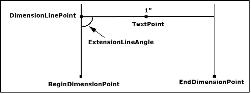

geodb_type: geodb_dimension
Dimension features are defined by the following attributes:
Attribute Name |
Contents |
geodb_dim_begin_dimension_x |
The X value for the Begin Dimension Point. |
geodb_dim_begin_dimension_y |
The Y value for the Begin Dimension Point. |
geodb_dim_begin_dimension_z |
The Z value for the Begin Dimension Point. |
geodb_dim_custom_length |
A length specified to be displayed instead of the actual length in geodb_dim_length. This value only gets used if geodb_dim_using_custom_length is set to true. Default: 0 |
geodb_dim_end_dimension_x |
The X value for the End Dimension Point. |
geodb_dim_end_dimension_y |
The Y value for the End Dimension Point. |
geodb_dim_end_dimension_z |
The Z value for the End Dimension Point. |
geodb_dim_extn_line_angle |
The angle (in degrees) between the dimension line and the extension line. Default: 90 |
geodb_dim_extn_line_display |
Specifies which dimension parts appear on the extension line. The valid values are the same as for geodb_dim_line_display. Setting this attribute overrides the value set by the dimension style. |
geodb_dim_length |
The length of the dimension. A read-only attribute. |
geodb_dim_line_display |
Specifies which dimension parts appear on the dimension line (that is, if they point inward or outward, etc.). The integer values for this parameter follow the Esri enumeration esriDimensionDisplay and the values are: 0 = Displays both dimension parts. 1 = Displays the beginning dimension part. 2 = Displays the ending dimension part. 3 = Does not display any dimension part. Setting this attribute overrides the value set by the dimension style. |
geodb_dim_line_x |
The X value for the Dimension Line Point. The Dimension Line Point determines the height of the dimension line above the baseline. To create a two-point dimension, the Dimension Line Point must be the same as the Begin Dimension Point. |
geodb_dim_line_y |
The Y value for the Dimension Line Point. The Dimension Line Point determines the height of the dimension line above the baseline. To create a two-point dimension, the Dimension Line Point must be the same as the Begin Dimension Point. |
geodb_dim_line_z |
The Z value for the Dimension Line Point. The Dimension Line Point determines the height of the dimension line above the baseline. To create a two-point dimension, the Dimension Line Point must be the same as the Begin Dimension Point. |
geodb_dim_marker_display
Specifies how arrows are displayed for the dimension. The values are the same as that of geodb_dim_line_display, except that they apply to markers (arrows) instead of dimension parts. Setting this attribute overrides the value set by the dimension style. |
geodb_dim_style_id |
The numeric ID describing which style this dimension uses. When writing dimensions this attribute must be supplied on the feature and be assigned an ID for an existing style, otherwise an error will occur. When translating from one Geodatabase dimension feature class to another, make sure that the destination feature class contains all the dimension styles used by the input dimension feature class. This may mean that the destination dimension feature class has to be created before the translation using ArcGIS. |
geodb_dim_text_angle |
The angle of the text displayed, in radians. From Esri’s documentation: "The TextAngle property will only affect the dimension if the dimension's style's text alignment property is True in which case the text is always parallel to the dimension line." Default: 0 |
geodb_dim_text_x |
The X value for the Text Point. If the x,y,z values for the text point are all zero then the default text position is used. Default: 0 |
geodb_dim_text_y |
The Y value for the Text Point. If the x,y,z values for the text point are all zero, then the default text position is used. Default: 0 |
geodb_dim_text_z |
The Z value for the Text Point. If the x,y,z values for the text point are all zero, then the default text position is used. Default: 0 |
geodb_dim_type |
Specifies whether the dimension is linear or aligned. Please reference Esri documentation on dimensions for specific definitions. The numbers specified follow the Esri enumeration esriDimensionType and the values are: 0 = aligned 1 = linear Default: 0 |
geodb_dim_using_custom_length |
Specifies whether or not to use the custom length specified instead of the actual length. Permitted values are true and false. Default: false |

geodb_type: geodb_pro_annotation
Features with this value represent the new annotations introduced in ArcGIS Pro.
Attributes are very similar to Annotations, with the following exceptions:
- no geodb_text_lc_textbox attribute when reading leader lines
- no geodb_text_part_count attribute
- geodb_text_leader_line is not used for writing
- “Line Callout” border attribute writing is supported. (These are “Background Callouts” in ArcGIS Pro)
The RGB color of the accent bar of “Background Callout” type leader lines. See geodb_color for a description of how color is represented in FME. |
The width in ground units of the accent bar of “Background Callout” type leader lines. |
The RGB color of the border fill on a “Background Callout” type leader line. |

geodb_text_lc_gap |
The bottom margin in ground units of “Background Callout” type leader lines. |
The left margin in ground units of “Background Callout” type leader lines. |
The right margin in ground units of “Background Callout” type leader lines. |
The top margin in ground units of “Background Callout” type leader lines. |
