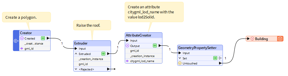

Setting the Geometry Role in FME Workbench
The geometry role can be set using the AttributeCreator and the GeometryPropertySetter transformers in tandem.
The AttributeCreator sets citygml_lod_name as an attribute, and then transforms it into a trait using the GeometryPropertySetter.
Since we've passed in a valid FME geometry for the geometry role (an extrusion as a lod2Solid), we end up with a Building feature containing this geometry in our output:
<cityObjectMember>
<bldg:Building gml:id="boring_building_11">
<bldg:lod2Solid>
<gml:Solid srsDimension="3">

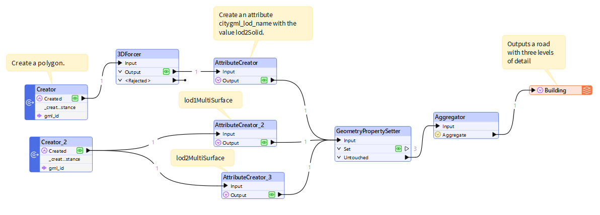

Writing Multiple Geometry Roles to One Feature
To create additional geometry roles for a feature, simply label a copy of the same geometry, or any other geometry with the appropriate role, and aggregate all of the geometries for the feature into a single geometry:
Here is the CityGML Road feature:
<tran:Road gml:id="2nd_west_boring_street">
<tran:lod0Network>
<gml:LineString srsDimension="3">
<gml:posList>12 0 0 12 12 0 0 12 0</gml:posList>
</gml:LineString>
</tran:lod0Network>
<tran:lod1MultiSurface>
<gml:MultiSurface srsDimension="3">
<gml:surfaceMember>
<gml:Polygon>
<gml:exterior>
<gml:LinearRing>
<gml:posList>13 0 0 11 0 0 11 11 0 0 11 0 0 13 0 13 13 0 13 0 0
</gml:posList>
</gml:LinearRing>
</gml:exterior>
</gml:Polygon>
</gml:surfaceMember>
</gml:MultiSurface>
</tran:lod1MultiSurface>
<tran:lod2MultiSurface>
<!--The same gml:MultiSurface as for the lod1MultiSurface-->
</tran:lod2MultiSurface>
</tran:Road>
