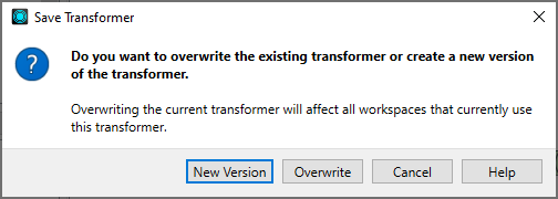

To create Version 2 of a custom transformer
  1. Open the custom transformer and make your desired changes
  2. Select File > Save on the menu, or click the Save icon on the toolbar.
  3. The following prompt displays:
  4. Click New Version.
The custom transformer is now saved as Version 2.

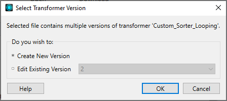

To create Version 3 or later of a custom transformer.
  1. Open the custom transformer.
  2. The following prompt displays:
  3. Select Create New Version and click OK.
The custom transformer is saved and opens as the next version.

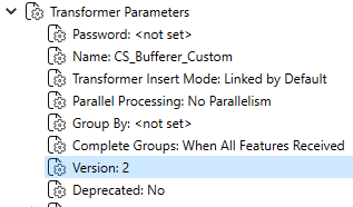

Getting the Version Number of a Custom Transformer
When you open a custom transformer, you can see the version number in the Navigator, under Transformer Parameters.
