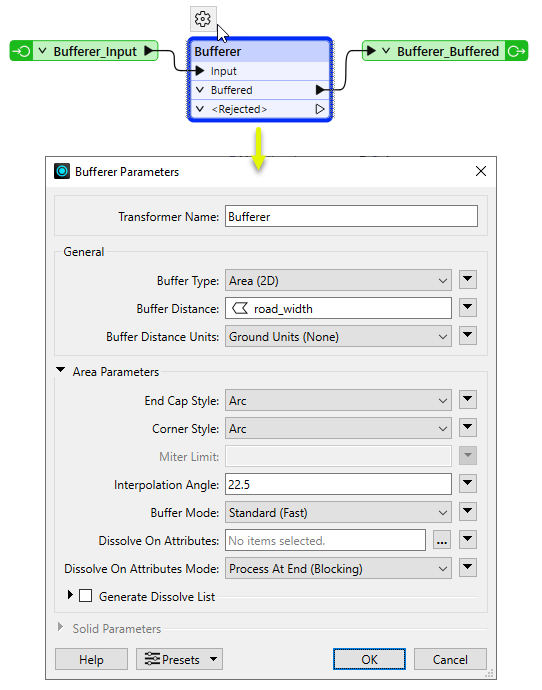

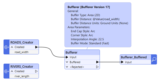

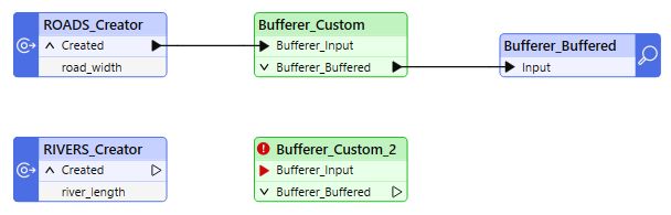

This example shows a set of transformers. As the Summary Annotation shows, the Buffer Amount field in the Bufferer is linked to the road_width attribute from the Creator.
Create a custom transformer from the Bufferer transformer. When the custom transformer appears, click the properties button. The Bufferer transformer is still referencing the original attribute from the Creator transformer.
Click the Main tab in the workspace window.

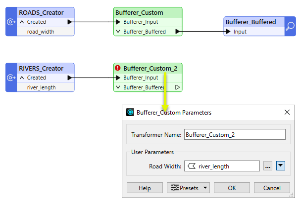

Select the custom transformer and copy/paste it (or choose Duplicate from the command menu). The duplicated transformer has a red warning because the transformer is looking for the original road_width attribute.
Click the tab that contains the new custom transformer.

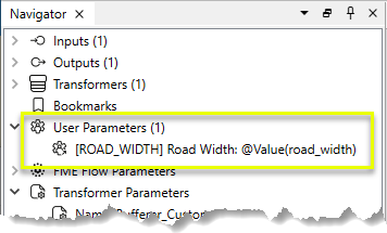

FME has automatically published the Buffer Amount parameter, and the missing attribute is listed under Published Parameters in the Navigator pane.
If you delete this published parameter, the properties button of the custom transformer will turn red, since it will still be trying to reference road_width. |
Publishing the parameters means that if you now connect the River features to the reused custom transformer, you have the option to choose river_length as the attribute, instead of road_width.

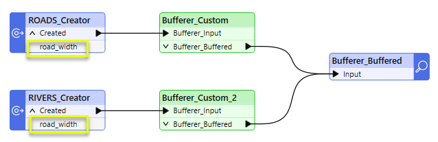

This alternate example shows the situation where both instances do use the same attribute.

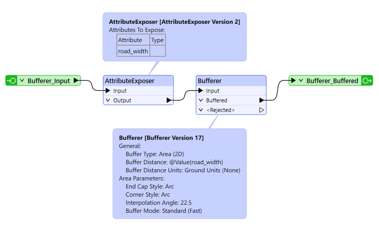

Inserting an AttributeExposer into the custom transformer can identify any hidden referenced attributes. In this scenario, there is no need to select a different attribute when you insert a custom transformer into a workspace.
In this example, we deleted the published parameter that FME created, and replaced it by inserting an AttributeExposer. By manually exposing the road_width attribute, we have made the attribute available within every instance of this custom transformer.
