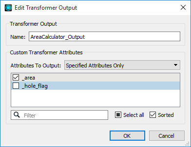

  • Specify any attributes to output (output port): In the Attributes to Output field, you can specify which attributes to output:
    • Specified Attributes Only: The port outputs only the attributes whose checkboxes are selected. Any attributes that are not selected are removed and are not available to subsequent custom transformers, workspaces or feature types.
    • All Attributes: The port outputs all of the attributes listed below the drop-down list.
    • In this example, only the _area attribute is output:
