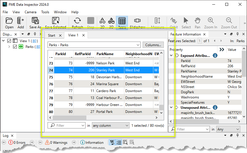

In addition to 2D or 3D view modes, you can view attribute data for features in table format. When either 2D or 3D view mode is active, the Table View appears outside of the View window, in another part of the interface (as long as it is selected in the View menu, under Windows). To replace the 2D or 3D data in the View Window with the Table View, click the Table View icon () on the toolbar, or press Ctrl+1 on your keyboard. The Table View appears directly in the View Window:
