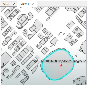

Using the mouse cursor
To mark a location using the mouse cursor, point the cursor to the desired location in the View window, right-click, and select Mark Location. A location marker appears, along with a label displaying the x,y coordinates.

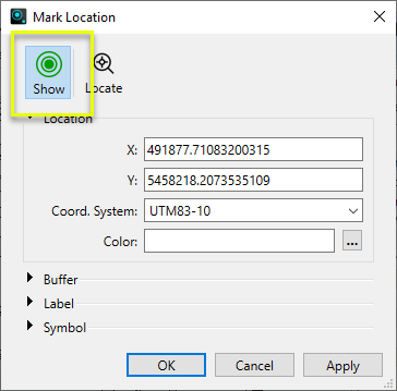

To hide a location marker in the view
In the Mark Location dialog, toggle the Show button to hide or show the location marker in the view, and click OK.

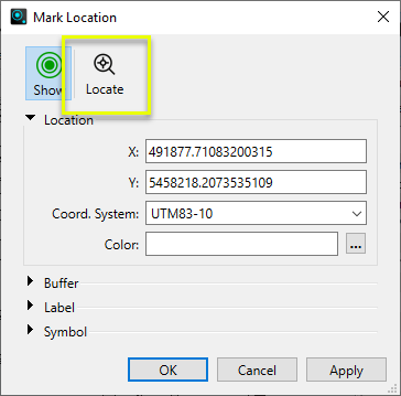

To zoom to a location marker in the view
In the Mark Location dialog, click the Locate button.
