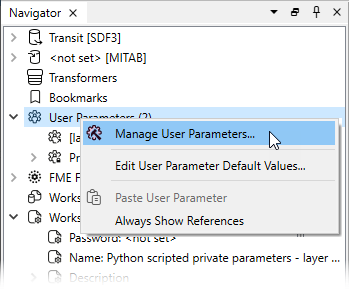

Open the Workbench User Parameters dialog.
The parameter is defined using the following options:
