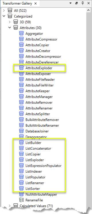

List transformers allow you to work with list attributes.
See the Attributes category in the Transformer Gallery:
Convert List Elements into Regular Attributes
You can use the ListIndexer transformer to convert elements of a structured list into full attributes, and the index can be either a number you provide directly, or one that you extract from another attribute on the feature.
