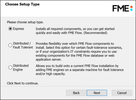

Choose Setup Type
Select the Express option.

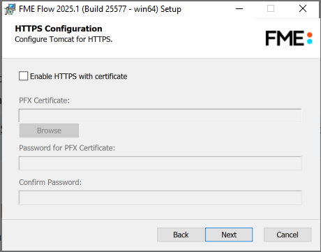

HTTPS Configuration
To enable the Apache Tomcat web application server for HTTPS, check Enable HTTPS with certificate and provide the path to your PFX certificate and the certificate password.
Note  If you do not configure for HTTPS during installation, you can configure it later. For more information, see Configuring for HTTPS.
