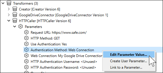

When you use a web connection in a workspace, the Navigator displays only the connection name. The service name, username, password, and other connection parameters do not display. For example, here is how connection information displays in the parameters of a transformer that uses a web connection.
Additionally, all web connections in the workspace are listed under Web Connections.

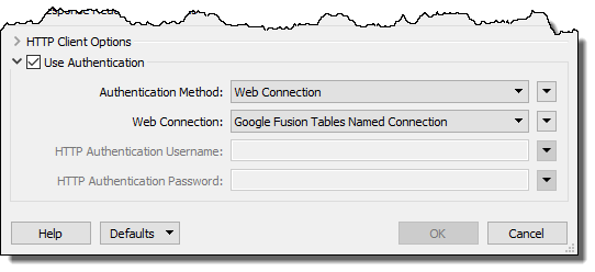

You can use an existing web connection, or define a new one, in a Transformer Parameters, Add Reader, or Add Writer dialog.

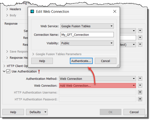

For example, in an HTTPCaller transformer parameters dialog, check Use Authentication. In the Authentication Method field, specify Web Connection. In the Web Connection field, specify the connection.
Alternatively, to create a new connection and use it right away, in the Web Connection field, specify Add Web Connection.
In the Edit Web Connection dialog, specify the web service, a name for the connection, and the connection parameters.
Warning For production purposes, we recommend specifying user-defined web services, rather than the pre-registered services already provided. For more information, see Managing Web Services.
If the web service that you specify adheres to the OAuth 2.0 standard and is not yet defined in FME, a Create New <web service> dialog opens that allows you to create the service dynamically. For more information, see Managing Web Services.
If the web service uses the OAuth standard, click Authenticate and validate your connection directly with the web service.

In the Navigator, right click on the Authentication Method parameter of the applicable object, such as a transformer, that is using the connection, and select a desired method for editing the authentication parameter.
