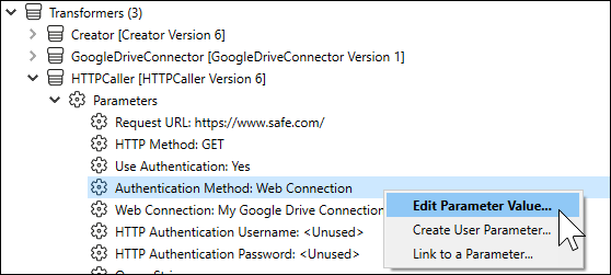

You can use an existing web connection, or define a new one, in a Transformer Parameters, Add Reader, or Add Writer dialog.
If the web service that you specify adheres to the OAuth 2.0 standard and is not yet defined in FME, a Create New <web service> dialog opens that allows you to create the service dynamically. For more information, see Managing Web Services.
