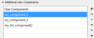

LAS supports storing additional components (not part of the fixed component set) for each point through an "extra bytes" Variable Length Record. The User Components parameter specifies a list of components that should be written for each point.
Note that the String data type is not supported for user components.
LAS supports "list" components with up to three elements. To write a list component, add the list suffix {} to the end of a component name. Note that each member of a list component must have the same data type.
You can add, remove, or re-order the list to change the order in which the components are stored in the output dataset.
