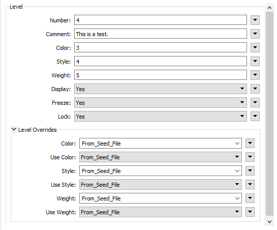

Examples
Open the Writer Feature Type Parameters:

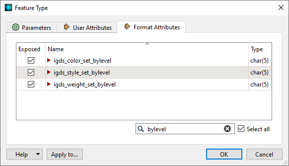

Note that if any feature being written to this level is intended to have symbology by_level, then the attributes igds_color_set_bylevel, igds_style_set_bylevel, and igds_weight_set_bylevel must be exposed in the Format Attributes tab:
The level override values on the Feature Type are separate from the feature attributes. They form an additional symbology for a written level, which is used with the Level symbology setting, taken from the seed file.
