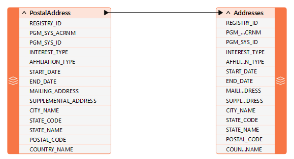

When a new workspace is created, FME scans all of the source datasets. From this it creates a visual representation of the data’s schema on the left side of the canvas. On the right side, it creates a visual representation of how this schema will be duplicated in the chosen output format.
Here are source and destination schemas as they are represented in Workbench.
Each object on the canvas is a separate Feature Type within a dataset.
The workspace reads from left to right.
At this point, the Reader schema represents what we have (so, FME's view of the source datasets). The Writer schema represents what we want (so, the data required by the user).
By default, the Writer schema is a mirror image of the source; differences only occur when demanded by limitations of the selected destination format. This allows quick translation to occur with no further workspace editing required.

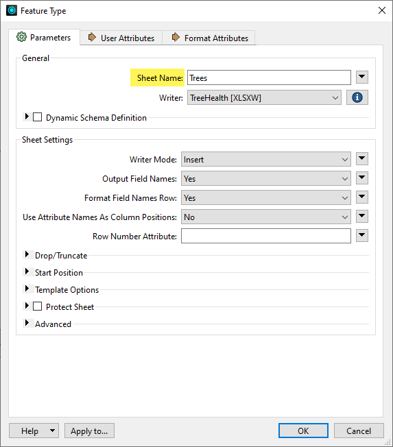

Feature Type Names
A Feature Type simply represents a layer of data. Because this is format-specific, FME uses the generic term Feature Type. The Name parameter label might be Feature Class, Layer, Sheet, Table, or whatever terminology is specific to the format of data you are writing. For example, an Excel feature type is a Sheet Name:
Reader feature types are disabled by default, since source attributes represent the physical schema of the data. If they were changed, the schema would no longer match the Reader dataset. (Note that it is possible to enable reader feature type editing, but this feature is only suggested for use in some advanced scenarios. See the FME Workbench help for more information.)
