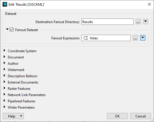

- In the Workspace Navigator, double click on the Destination dataset of the writer you want to fanout.
- In the Destination Fanout Directory field, specify a directory to hold the fanout datasets.
- Check Fanout Dataset and provide a Fanout Expression to indicate how you want to fanout the dataset.
- Click OK.
An Edit Dataset dialog opens.
Click the ellipsis
to use the Text Editor to assemble an expression of constants, parameters, and output attributes.
For File-Based Datasets, the expression should evaluate to the full filename of the output files, including any prefixes and file extensions (for example, internal\KML\@Value(PathName).gml or @Value(PathName).dwg).
For example,
you want to perform a dataset fanout in Google KML format, and three features
are output: two have Votes attribute equal to candidate, and one has Votes attribute equal to write_in. If Destination Fanout Directory is C:\ and Fanout Expression is Votes (or @Value(Votes) in the Text Editor), you will end up with datasets in two folders: c:\candidate\ and c:\write_in\. The output filenames will be based on the output feature types specified in the workspace.
