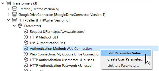

Working with Web Connections in a Workspace
You can use an existing web connection, or define a new one, in a Transformer Parameters, Add Reader, or Add Writer dialog.

To create a new connection in a transformer, such as FME FlowJobSubmitter, and use it right away, select Add Web Connection.
