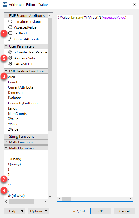

Similarly, in the AttributeCreator transformer, you could create an attribute such as a property’s Taxable Value using an expression such as (@Value(TaxBand) * @Area())/$(AssessedValue).
The numbers 1-5 show the order in which the elements were added to the editor:
