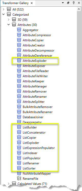

See the Attributes category in the Transformer Gallery:

Other List Operations
Examples of other list operations include:
- Searching a list (ListSearcher) for a particular value
- Counting the number of elements in a list (ListElementCounter)
- Concatenating all the elements of a list into a single attribute (ListConcatenator)
- Exploding a list by creating a new feature for each element in the list and adding its attributes (ListExploder).
