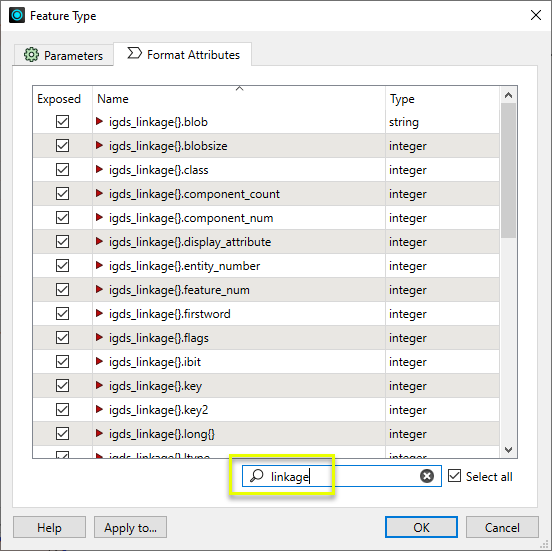

Open the reader Feature Type dialog and click the Format Attributes tab:

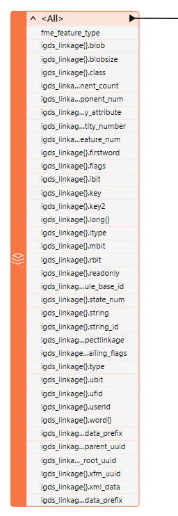

Locate the igds_linkage attributes and enable the checkboxes:

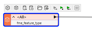

Click OK. The attributes are added to the feature type:
