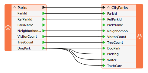

You have one input attribute that you want to connect to several destination attributes. Manually connecting each one would take some time. This is a simple example that shows a few attributes:

The attributes are connected in the workspace:
