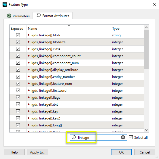

Open the reader Feature Type dialog and click the Format Attributes tab:

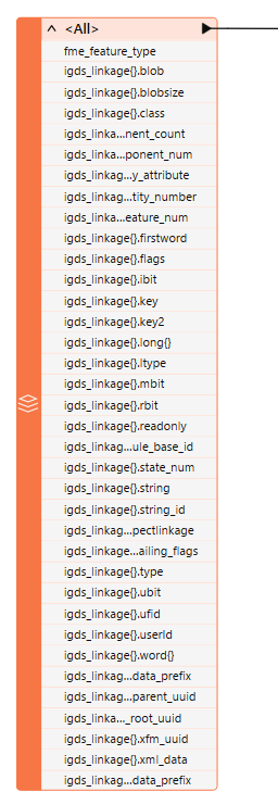

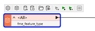

Locate the igds_linkage attributes and enable the checkboxes:
Click OK. The attributes are added to the feature type:
