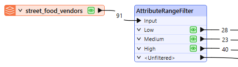

In this example, we want to categorize food vendors by the amount of daily traffic they have. The features are routed into an AttributeRangeFilter.

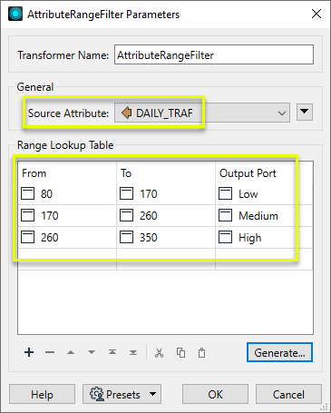

In the parameters dialog, we use the Generate… option to calculate three equal-interval ranges, based on our knowledge of the upper and lower limits of the daily traffic attribute values.
The intervals are calculated and added to the Range Lookup Table, with output ports automatically named. Note we have also selected the DAILY_TRAF attribute as our Source Attribute for categorization.
Lastly, we will overwrite the auto-generated Output Port names with meaningful names.

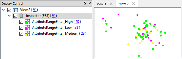

The features are output via the appropriate range’s Output Ports.
