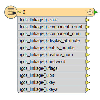

Certain FME readers make use of attribute lists to represent recurring values read from the original data source, particularly when the number of such values is not known ahead of time. In these cases, the unqualified list can be exposed in FME Workbench, and optionally a number of elements can be explicitly exposed and then treated as normal attributes.
For example, the DGN format returns IGDS linkages in list form.
Open the reader Feature Type dialog and click the Format Attributes tab:
Locate the igds_linkage
attributes and enable the checkboxes:
Click OK. The attributes are added to the feature type:
