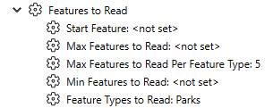

Limiting the Number of Features to Read
You can limit the number of features that you want FME Workbench to read, and then set the feature number at which to start. This feature is useful if, for example, you have a table that contains many spatial elements and you want to process only a portion of those elements for testing purposes.
Under the reader, expand Parameters > Features to Read, then double click Max Features to Read to set the maximum limit, and then Start Feature to set a feature above 1.
- Improving workspace performance: If this parameter is set, FME Workbench still reads all features, but discards the ones prior to this setting so they do not process downstream.
 - Database formats: FME Workbench does not guarantee the order in which features of database formats are read.
Where possible, use format-specific parameters, such as a WHERE Clause, to limit the number of features to read for performance improvement or with database formats.
In this example, when you run the Workspace, it will only read the Parks feature type, starting at feature 1, to a limit of 50.
If you are reading multiple feature types, you can use the Max Features to Read Per Feature Type parameter to ensure that a maximum number of features is read from each one. In this example, a maximum of five feature types will be read from each feature type.
In contrast, consider if Max Feature Types to Read Per Feature Type is not set, and Max Feature to Read is set to 15. In this case, there is no way to specify from which feature type the fifteen features are read.
