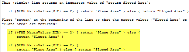

Note  Your code must contain a return statement on the last line of code. If there is no return statement (and assuming there is more than one line of code) FME will add return to the beginning of the line. Example for single lines of code:
When finding the last line of code, multiline statements or comments are not supported.
