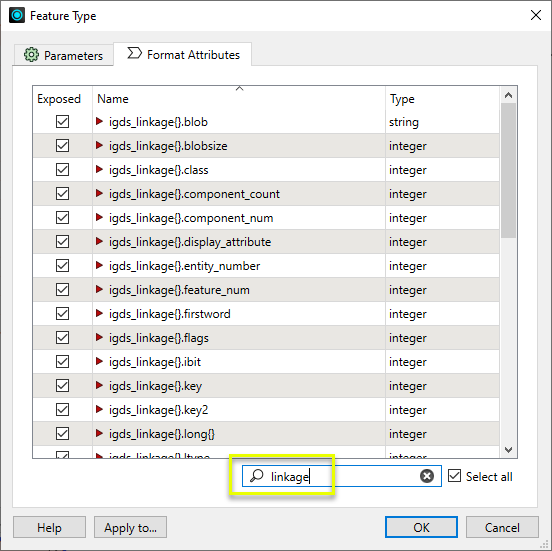

Open the reader Feature Type dialog and click the Format Attributes tab:
Locate the igds_linkage
attributes and enable the checkboxes:

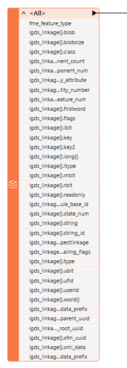

Click OK. The attributes are added to the feature type:
