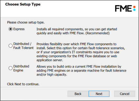

Choose Setup Type
Select the Express option.
