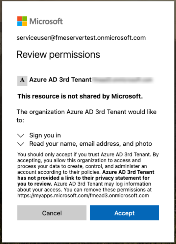

  4. Sign in as the administrator. A dialog opens that allows you to grant secondary tenant access to FME Server.
  5. Mouse-over for example:
