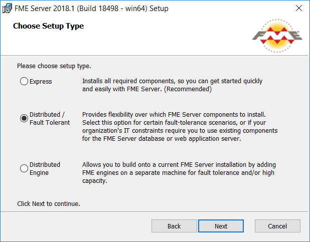

Choose Setup Type
Select the Distributed/Fault Tolerant install option.

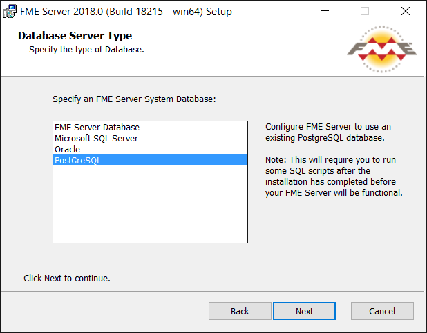

Database Server Type
Specify the type of database for the FME Server Database. For more information, see Provide a Database Server.
Note  Do not specify the "FME Server Database".
