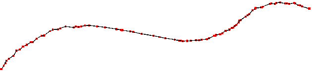

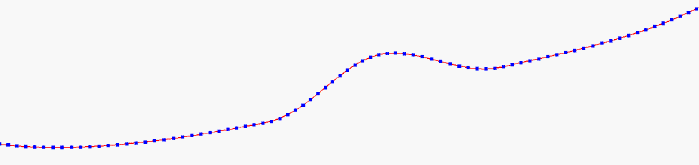

Example 1: This simple linestring could have been extracted from any FME-supported format. It’s made up of 85 straight line segments.

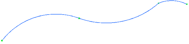

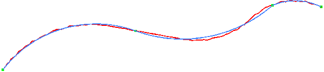

First we try a precision of 0.5 feet
This creates a solution made up of 3 arc segments. Notice that this solution yields a fairly smooth transition between the leftmost segment and the middle segment but the rightmost segment is less smooth – the rightmost two segments are obviously not tangent.

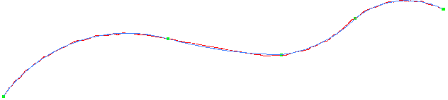

Try a more precise setting
In this situation we may get a more accurate and smoother solution by using a smaller Precision value. This is often the case when accuracy and/or smoothness are the most important aspects of the desired result.

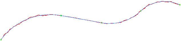

Next we’ll try a Precision of 0.2 feet
This yields a solution with 4 Arc segments. It fits the original linework more closely and the solution is somewhat smooth but it’s not perfectly smooth.

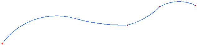

The Curvefitter allows the adjustment of 3 Weights: Compression, Smoothness and Accuracy. Our “ideal solution” is defined as very smooth (because the linework probably originated as engineered segments that were perfectly tangent) and we are not so much interested in maximum vertex reduction, so we can adjust the Curvefitter Emphasis to achieve that goal. We will express our desired ideal solution by emphasizing Smoothness the most, Accuracy somewhat less and compression very little.
Curvefitter Emphasis Settings:
- Precision: 0.2
- Compression: 0.1
- Accuracy: 1.0
- Smoothness: 10

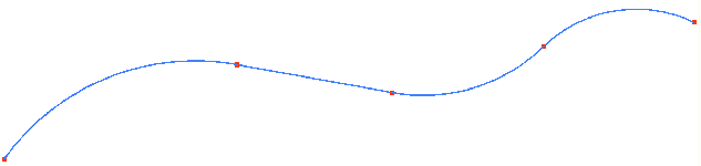

The results – nearly perfect smoothness and still accurate to within 0.2 feet.
This solution uses 4 segments: an Arc, followed by a straight segment, followed by 2 arc segments (left to right). This is our “Ideal Solution” realized.

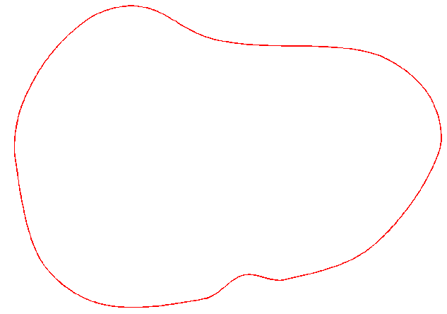

Example 2: This linestring could have been extracted from any FME-supported format. It’s a closed polygon, very smooth and it’s made up of 440 straight line segments.
440 straight segments
Area = 260,909
Our Ideal Solution

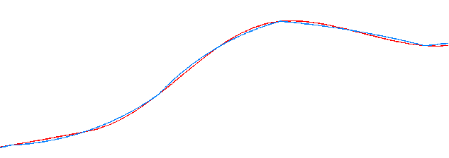

A close-up view of the polygon with the vertices highlighted.

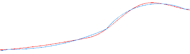

Our first guess for Precision will be 1. We will start with Balanced Emphasis and look at the resulting polygon overlaid with the original.
Curvefitter Settings:
- Precision: 1
- Emphasis = Balanced (all set to 1)
- Results
- Vertex Reduction = 1 : 25.88
- Area of CF polygon = 261004
- Area Difference = 0.0364%
We can see that these settings give us more than a 25:1 compression, fairly accurate reproduction of the polygon and a very slight change in area.

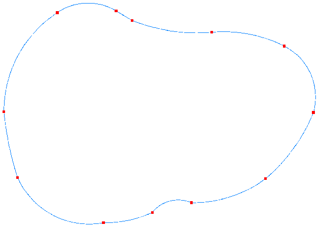

Curvefitter results – 12 segments
11 arc segments and 1 straight segment
Area = 261,05
