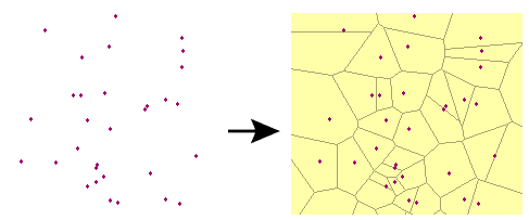

A Voronoi diagram is a set of polygons that represent proximity information about a set of input points. Each polygon in the diagram defines the area of space that is closest to a particular input point.
Note: If a Voronoi diagram is to be made from points with elevations, and you want to add additional breakline and tolerance options, consider using the SurfaceModeller transformer.
Example
The extent of the Voronoi diagram is guaranteed to cover the bounding box of all the input Point features. At least three points must be input.
Features input to the optional MinimumVoronoiExtent port will expand the extent of the resulting diagram to include their bounding box. This provides a way of extending the bounds of the diagram well past the extent of the input points.
