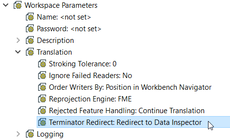

Terminator Redirect
If you are programming or debugging, you would usually disable the connections to the Terminators and then add an Inspector to verify if the features are real errors. In production mode, you have to re-enable these connections and delete the Inspector.
This option allows you to automatically redirect the features that enter the Terminator to a Inspector, without having to modify the workspace. When this option is activated, all the features that enter a Terminator are redirected to an Inspector and the translation continues without stopping. A message is added to the log file to indicate that some features were redirected to an Inspector.
